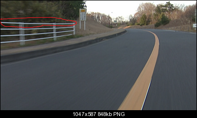

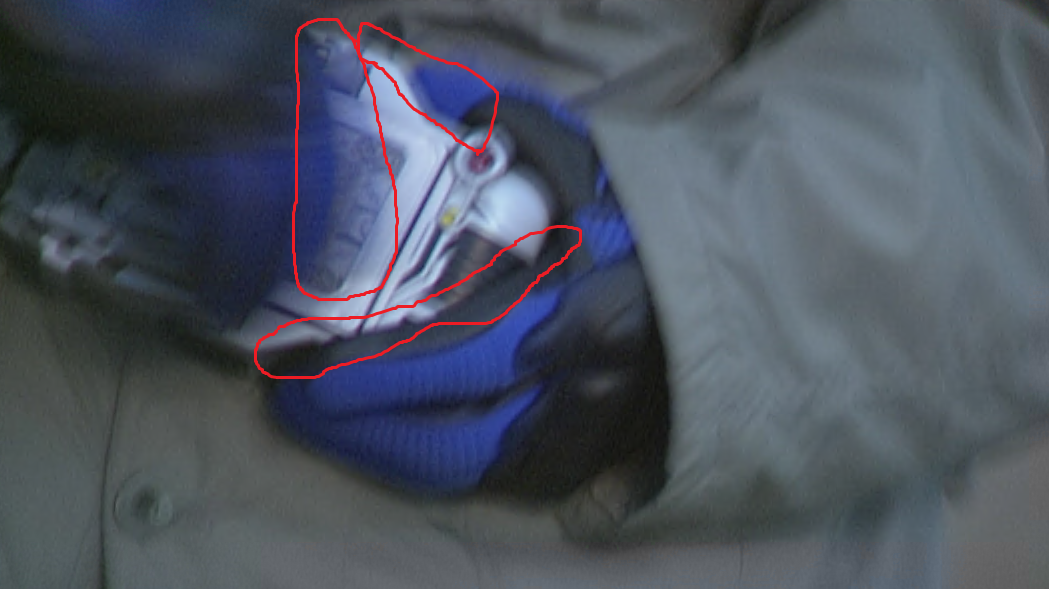

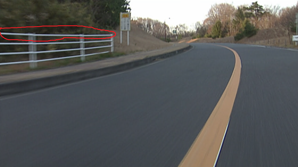

  1. Hello, I am trying to convert a bluray a series for episodes using MeGUI program and have a little knowledge about it, but I'm having problems with the generated image, I see something like a shadow or poorly done edges, and sometimes the video is kinda slow, follows the print to see:

    I've tried to deinterlace the video with all available filters that know and the result is basically the same. I think this is a bluray dvd upscale a 480i.

    And again we have a Groundhog Day ... Your use of DirectShowSource probably messed up the video in a way that it might insert or remove single frames which would confuse a decimate filter. And who knows if there is any DirectShow filter in the filter chain which blends fields before you can work with them?
    Many people with a lot of experience always recommend not to use DirectShowSource when you can avoid it. You should instead prefer L-SMASH Works (LwLibavVideoSource) or FFMS2 indexing (FFVideoSource) or one of Donald Graft's hardware decoder source filters (DGDecode...), using the "File Indexer" tool in MeGUI. They would certainly deliver the decoded frames as they are, in optimal quality, without any possibly surprising and unexpected post-processing.
    I would not even be sure that you have telecined video in a HD resolution. Are you really sure that it has a 3:2 Pulldown pattern?
  3. It looks like upscaled standard definition video in those pictures. But there's no way of saying for sure since we don't know exactly how you prepared the images.
    If you really have interlaced video you need to deinterlace before downscaling. And decimating doesn't make sense unless it's film based. If it's film based it should be field matched before decimating.

  10. It's pure interlace. You couldn't figure that out for yourself? As jagabo suggested earlier, bob it to 59.94fps for best results. And the best bobber is QTGMC, although it's very slow.

  12. If you want to try reducing the oversharpening halos:
    LWLibavVideoSource("exemple.mkv")
    SetMtMode(2)
    QTGMC(preset="fast") # or as slow as you can stand
    Dehalo_alpha(rx=4, ry=5)
    Spline36Resize(1280,720)
    Sharpen(0.3)
    That gets rid of most of the halos but loses a little detail. You might be able to keep more detail by adjusting the other dehalo_alpha() settings like brightstr, darkstr, lowsens and highsens.
